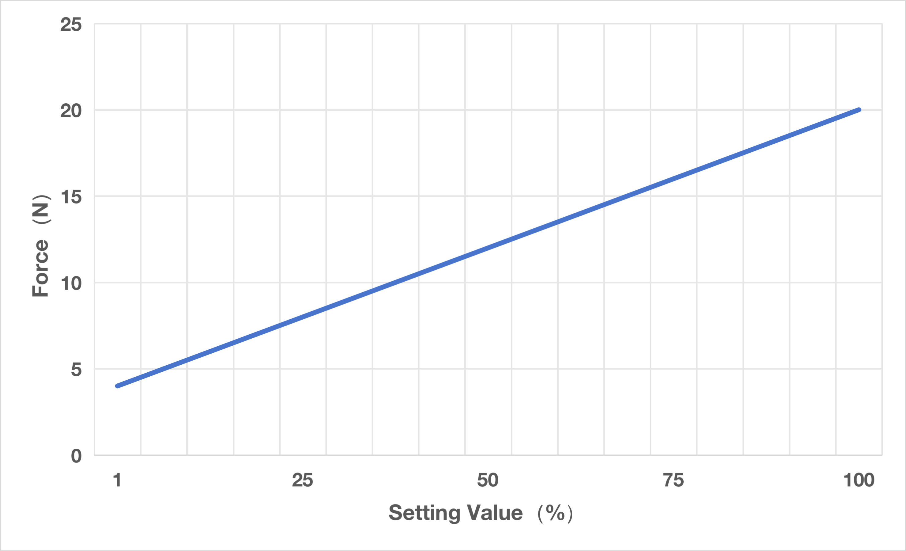

  • Force: 1-100 (percentage), The force setting value is expressed as a percentage, so refer to the following chart for the corresponding actual force.

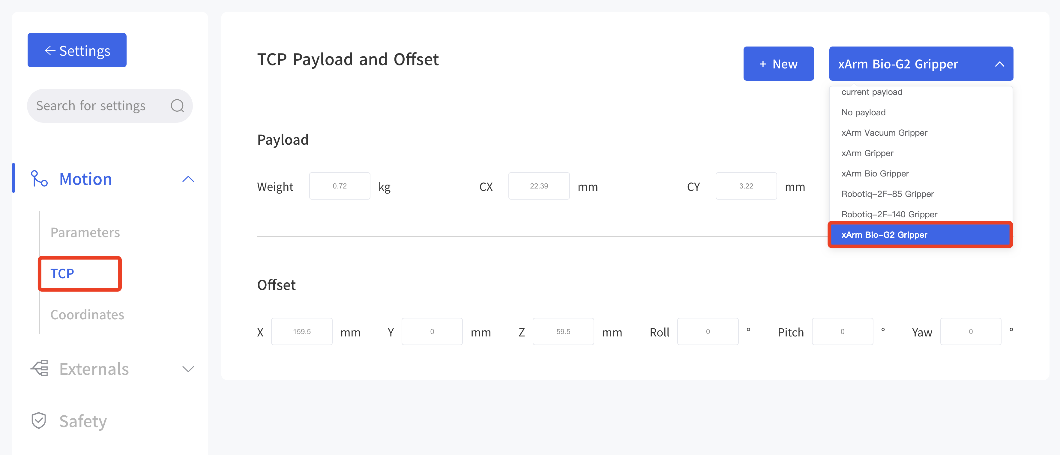

Set up BIO Gripper G2
Enter Settings-Motion-TCP. Select the end effector: xArm BIO G2 Gripper

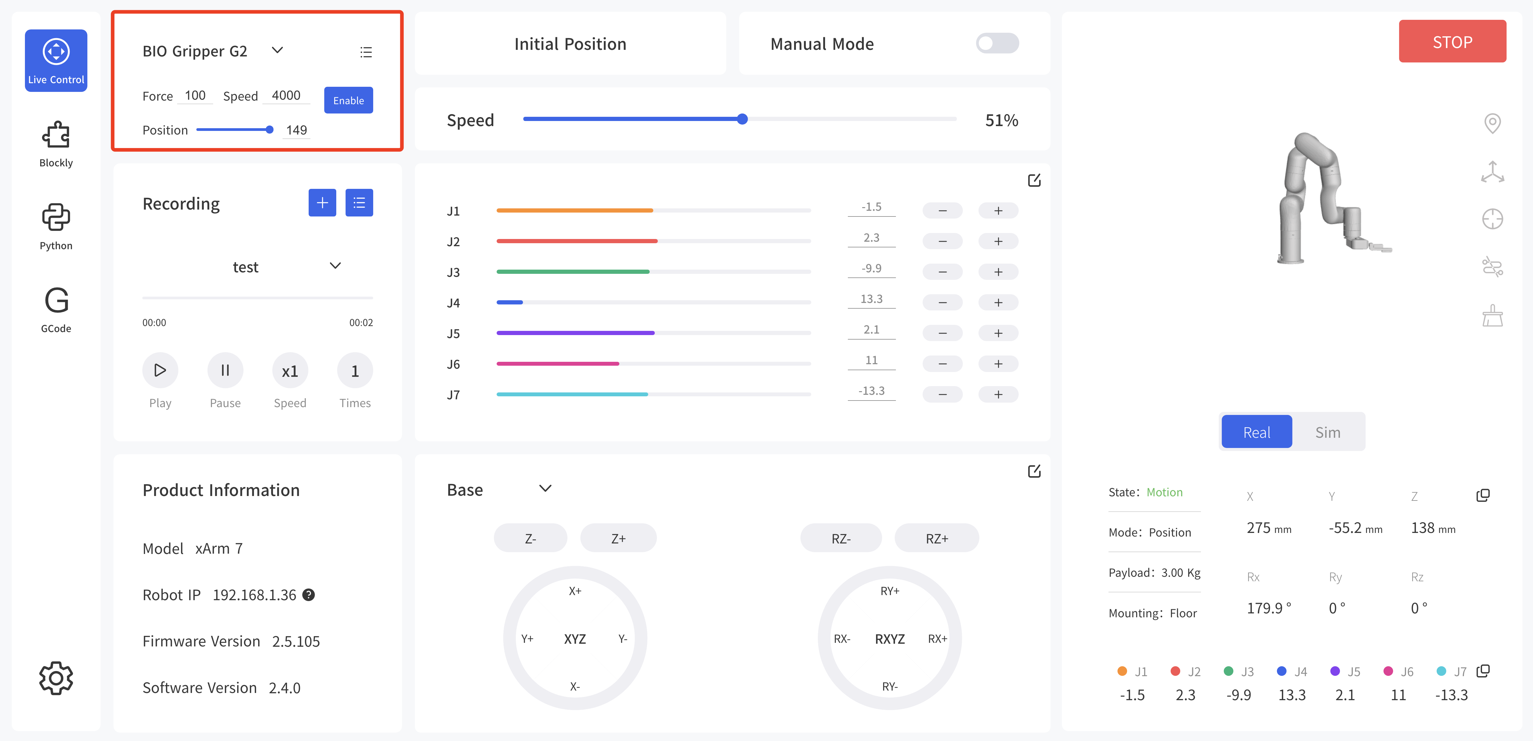

3.1.1 Live Control ​
Enter the live control interface and select BIO Gripper G2 for enable, speed, force and position control.

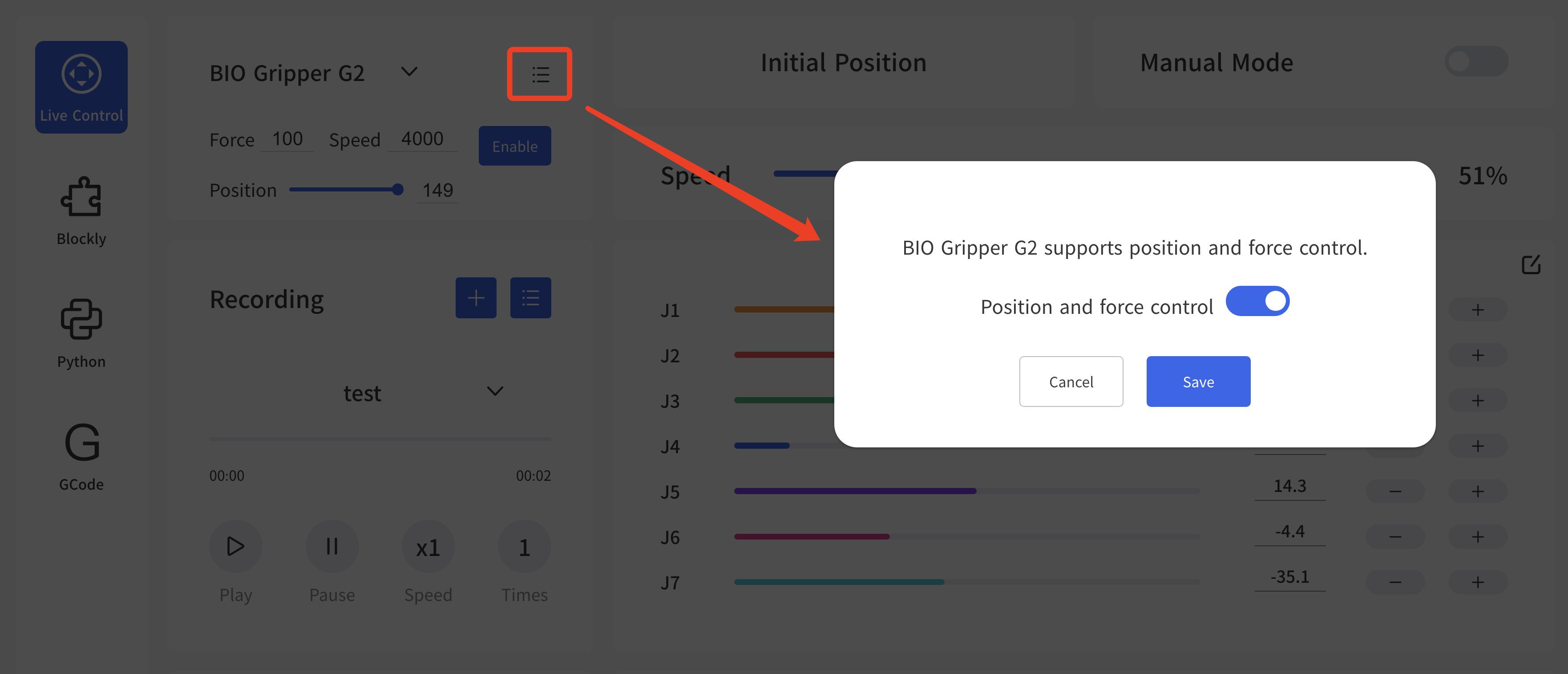

Click the upper right button to turn off the position and force control (switching mode).

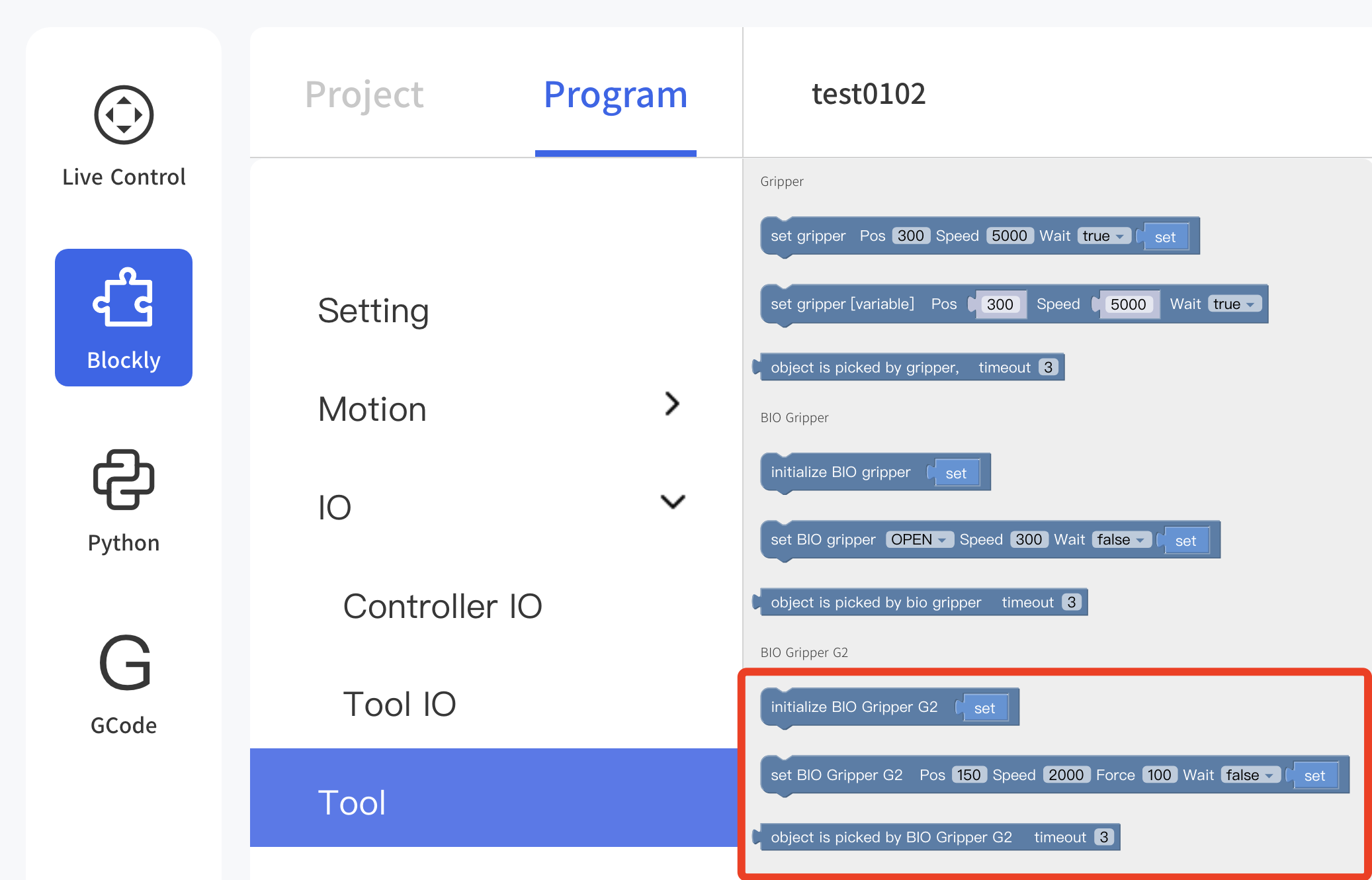

3.1.2 Blockly Control ​
Blockly provides 3 blocks to control the BIO Gripper G2:
  • Initialize the BIO gripper G2.
  • Setting up the BIO Gripper G2, parameters: position, speed, force, wait or not.
  • Detect that BIO Gripper G2 has clamped an object, parameter: timeout time.

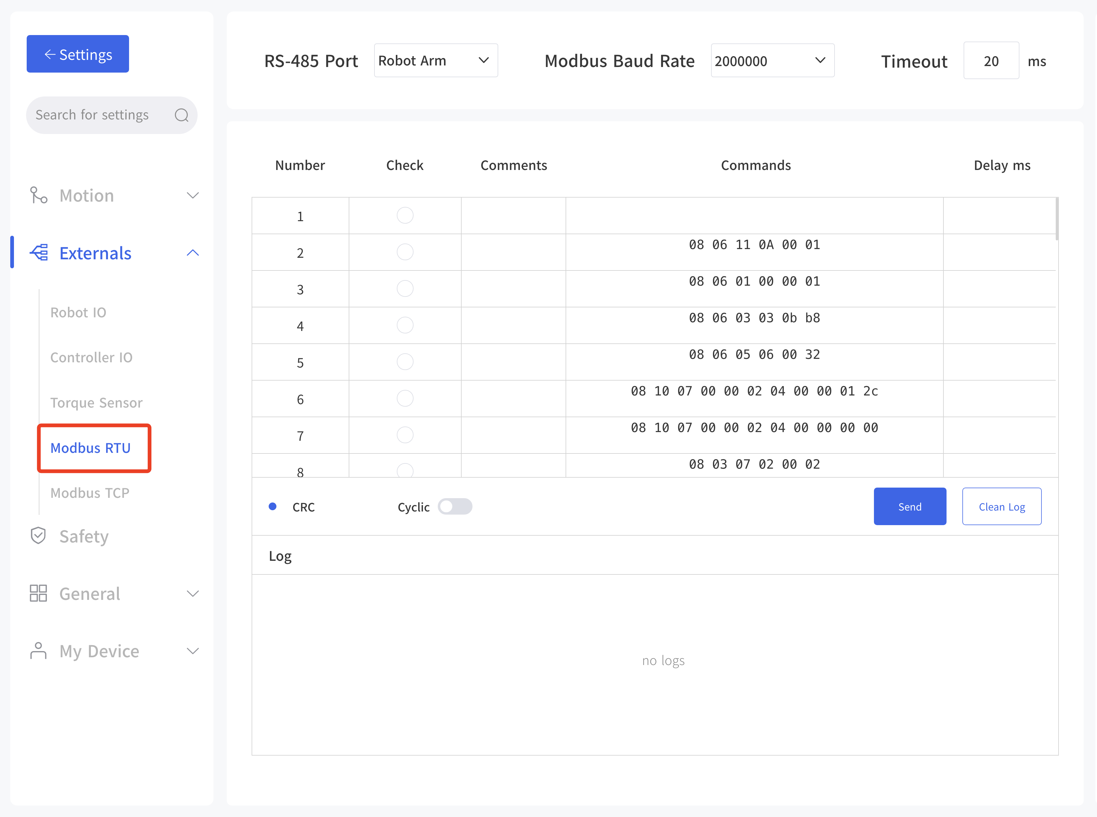

3.1.3 Modbus RTU Control ​
Enter to Set-Externals -Modbus RTU page and send the corresponding Modbus RTU commands for control.
For Modbus communication protocol, please refer to Modbus-RTU Communication Protocol Control

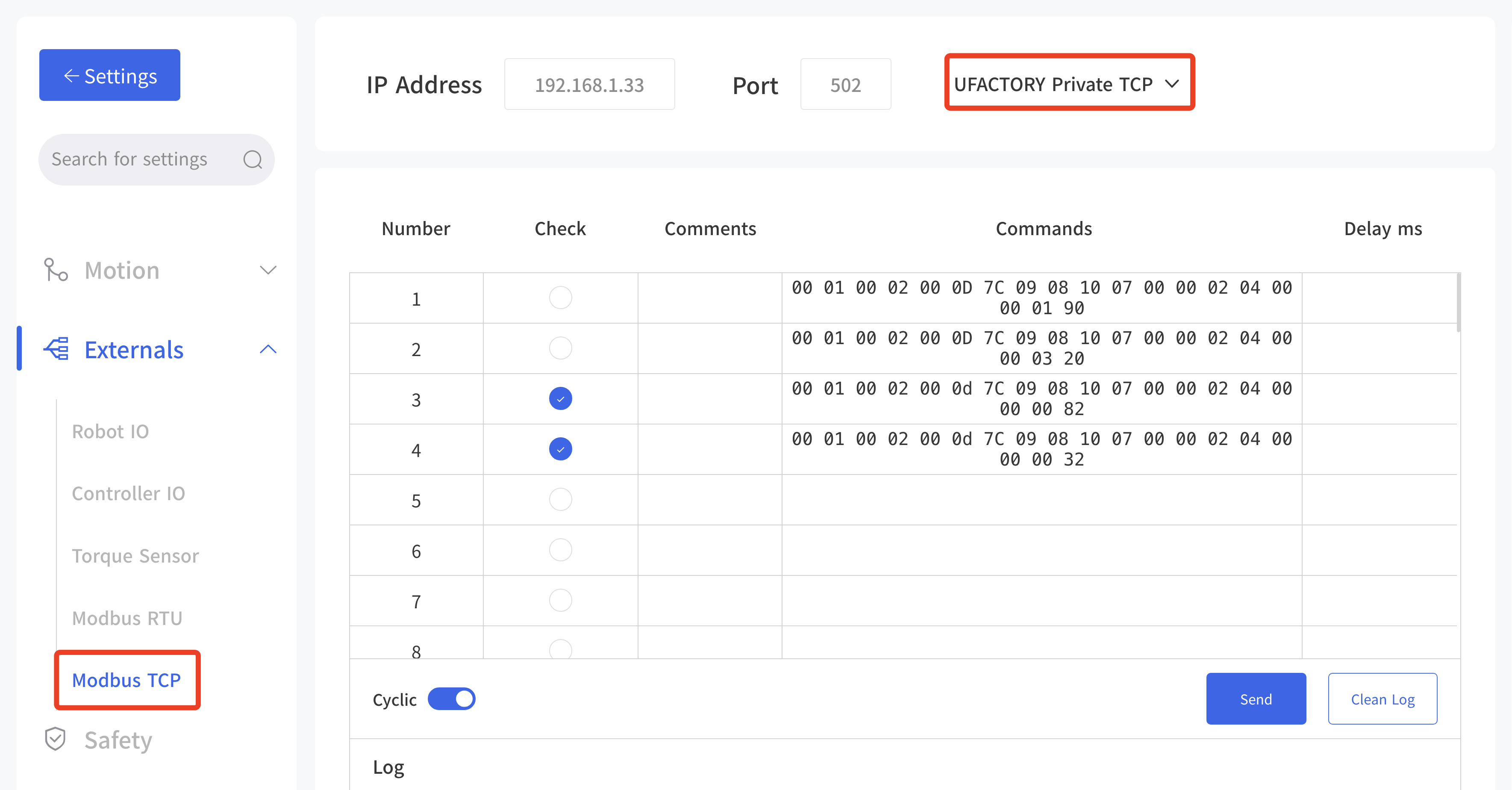

3.1.4 Private TCP Control ​
Enter to Set-Externals -Modbus TCP,select the "UFACTORY Private TCP",Send the appropriate private TCP commands for control
For Modbus communication protocol, please refer to UFACTORY Private TCP protocol control
