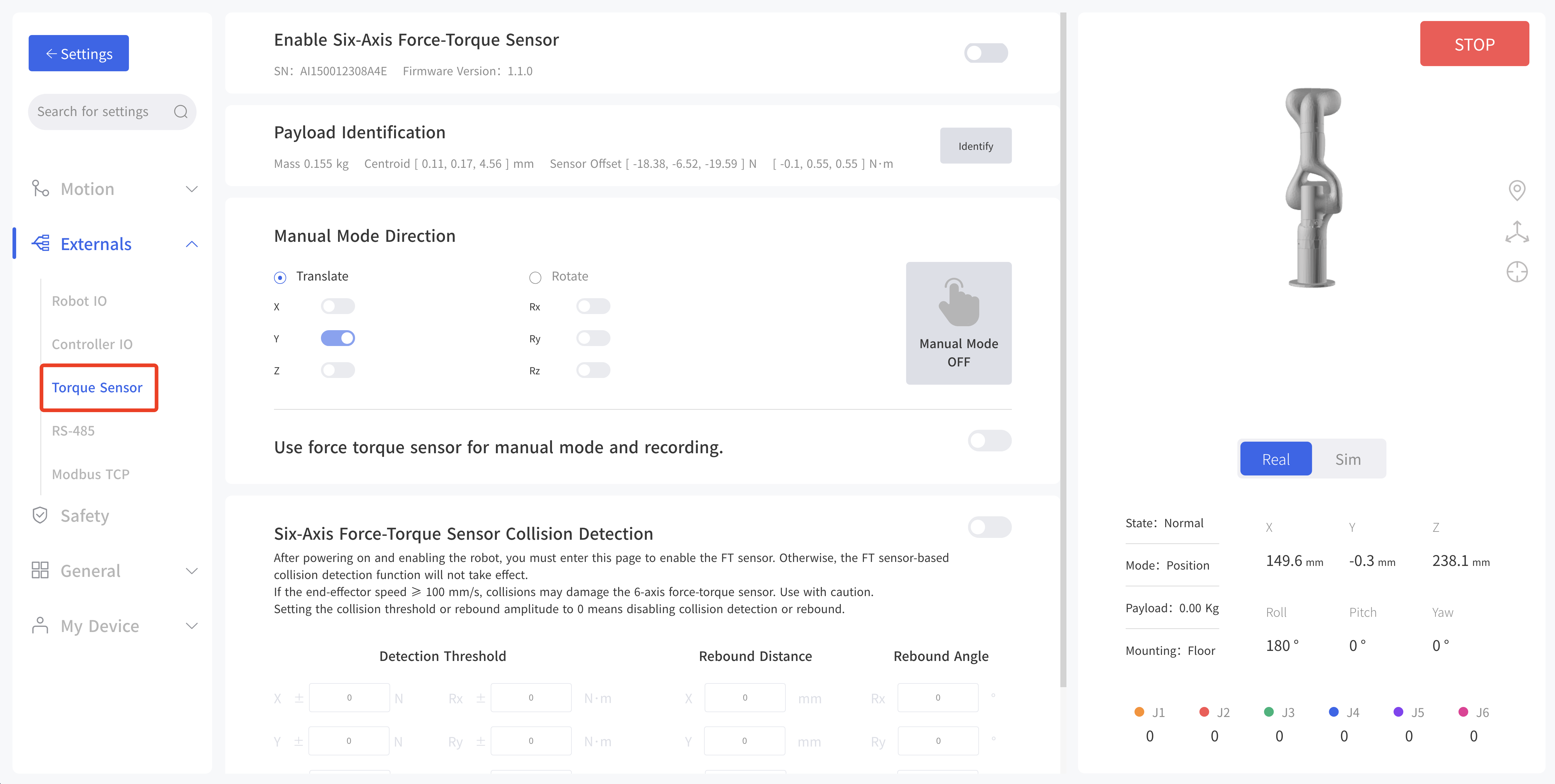

3.1 UFACTORY Studio ​
3.1.1 Settings ​
  • Enable Six-Axis Force-Torque Sensor: Enable, obtain and display SN and Firmware Version.
  • Payload Identification: During this process, the robotic arm will perform a series of actions, it will take around 5 minutes. It will get mass, centroid and sensor offset.
  • Manual Mode Direction: The direction of translation or rotation can be selected. After activation, the torque manual mode will be enabled.
  • Use force torque sensor for manual mode and recording
  • Six-Axis Force-Torque Sensor Collision Detection: Set Detection Threshold, Rebound Distance, Rebound Angle.

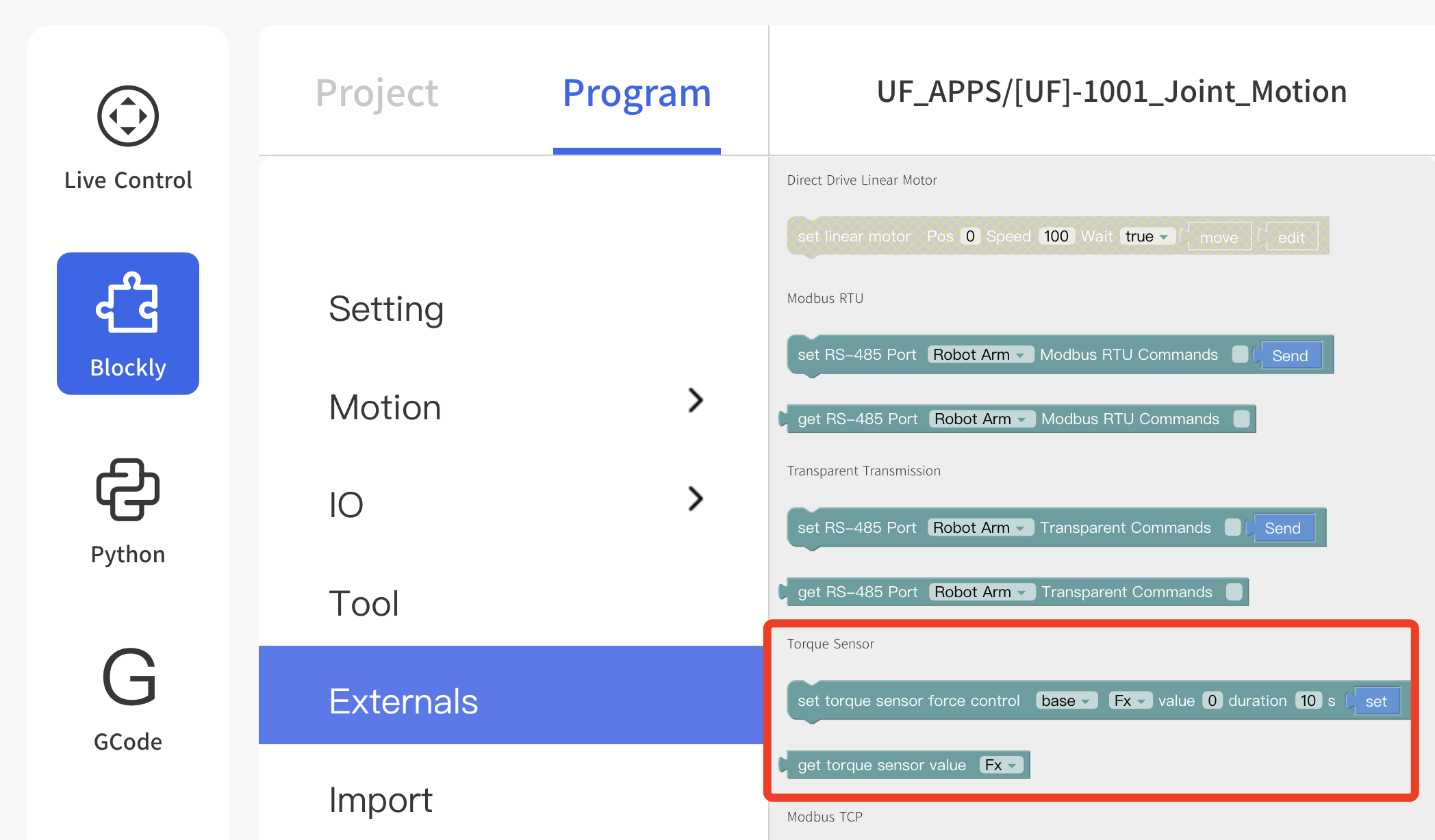

3.1.2 Blockly ​
  • set torque sensor force control: Programmable parameters are as below. coordinate Frame: base, tool
    direction: Fx, Fy, Fz, Tx, Ty, Tz
    value: -105~105N(Fx,Fy,Fz); -2.8~2.8N(Tx,Ty,Tz)
    duration: 0-9999s
  • get torque sensor value: Programmable parameters are as below. direction: Fx, Fy, Fz, Tx, Ty, Tz

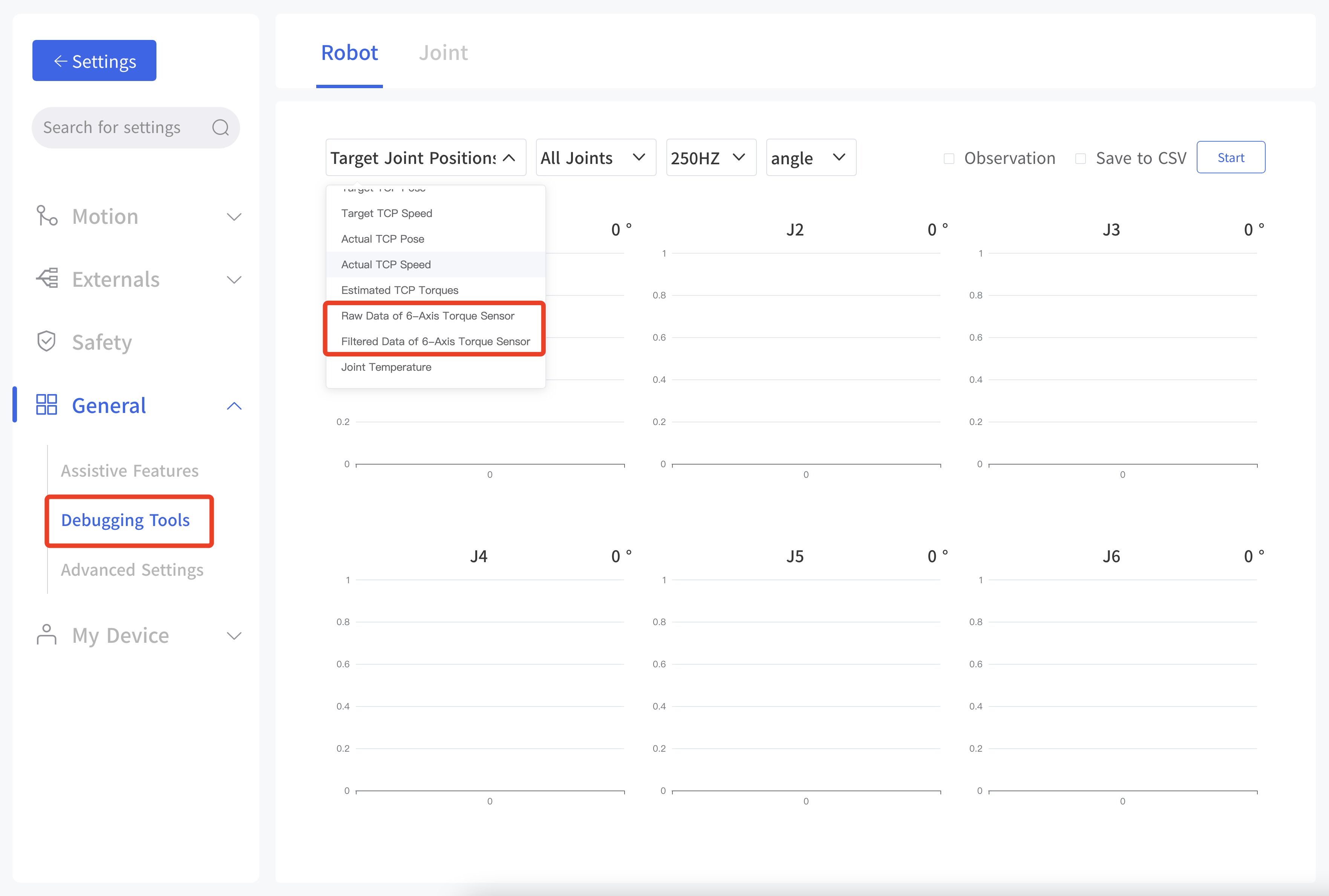

3.1.3 Data Observation ​
Enter Settings - General - Debugging Tools - Robot, check 'Observation' or 'save to CSV' box, click start, and obtain data via TCP port for plotting.
  • Item: Raw Dat of 6-Axis Torque Sensor, Filtered Data of 6-Axis Torque Sensor.
  • Joint: All joints, single joint
  • Frequency: 200HZ, 5HZ
  • Unit: angle, radian
