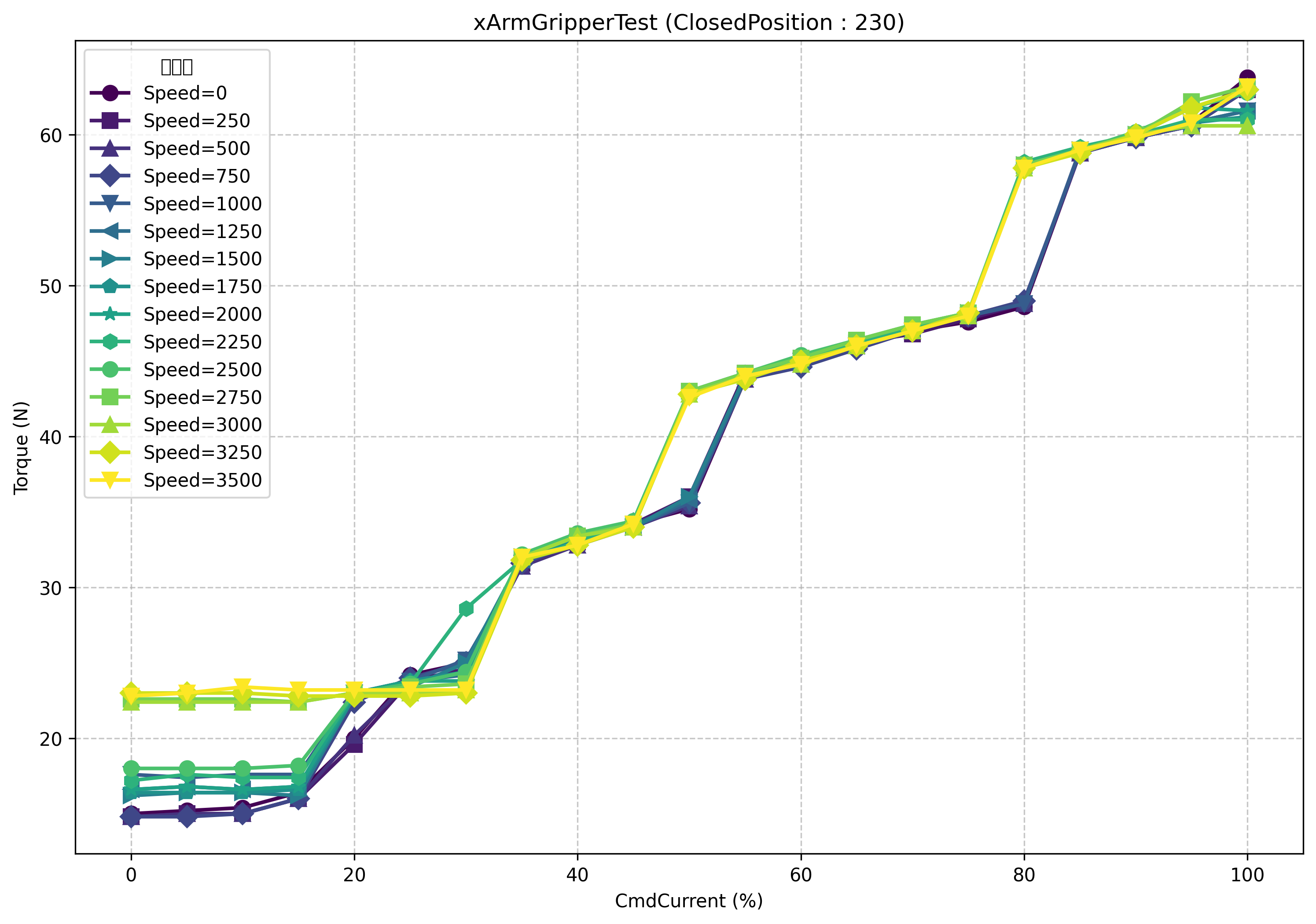

  • Force: 1-100 (percentage), The force setting value is expressed as a percentage, so refer to the following chart for the corresponding actual force.

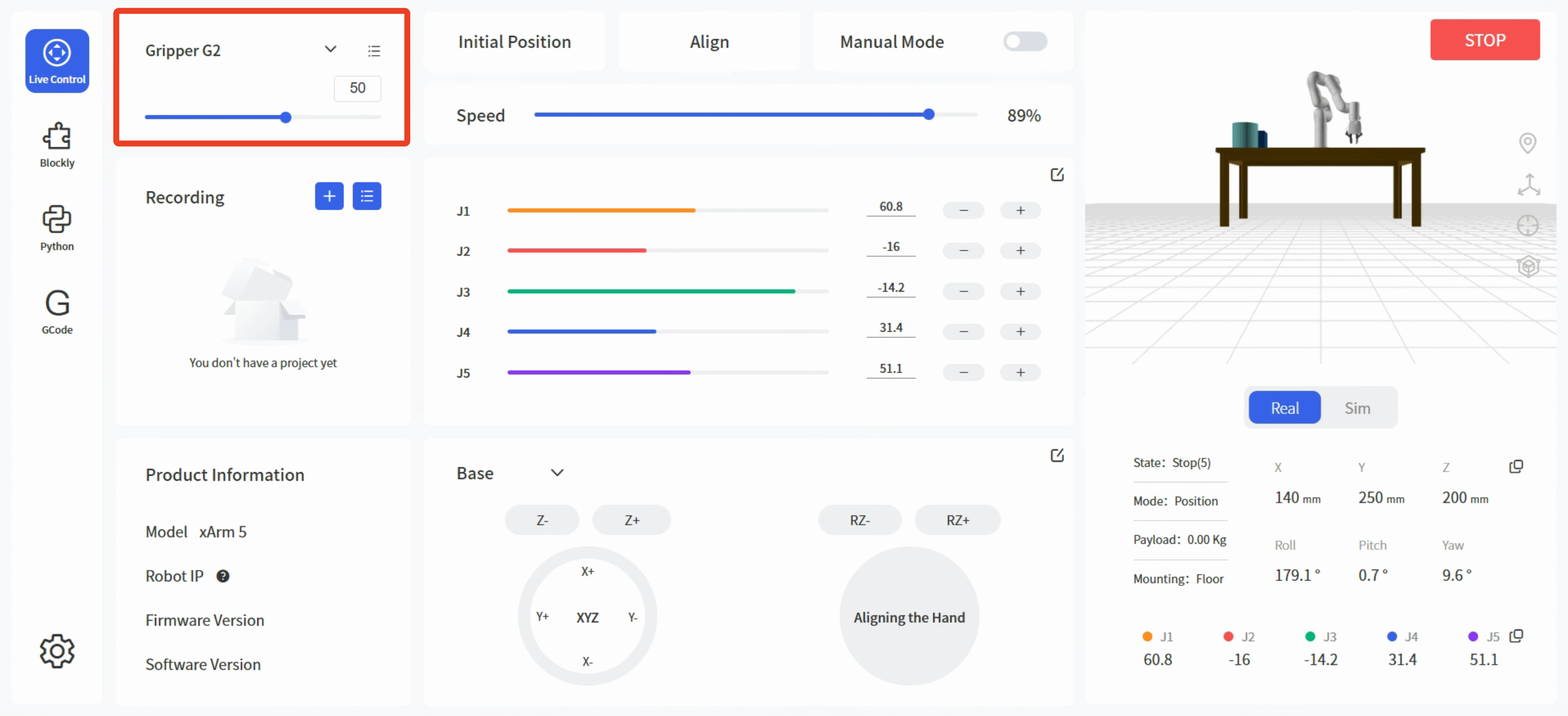

3.1 UFACTORY Studio ​
3.1.1 Live Control ​

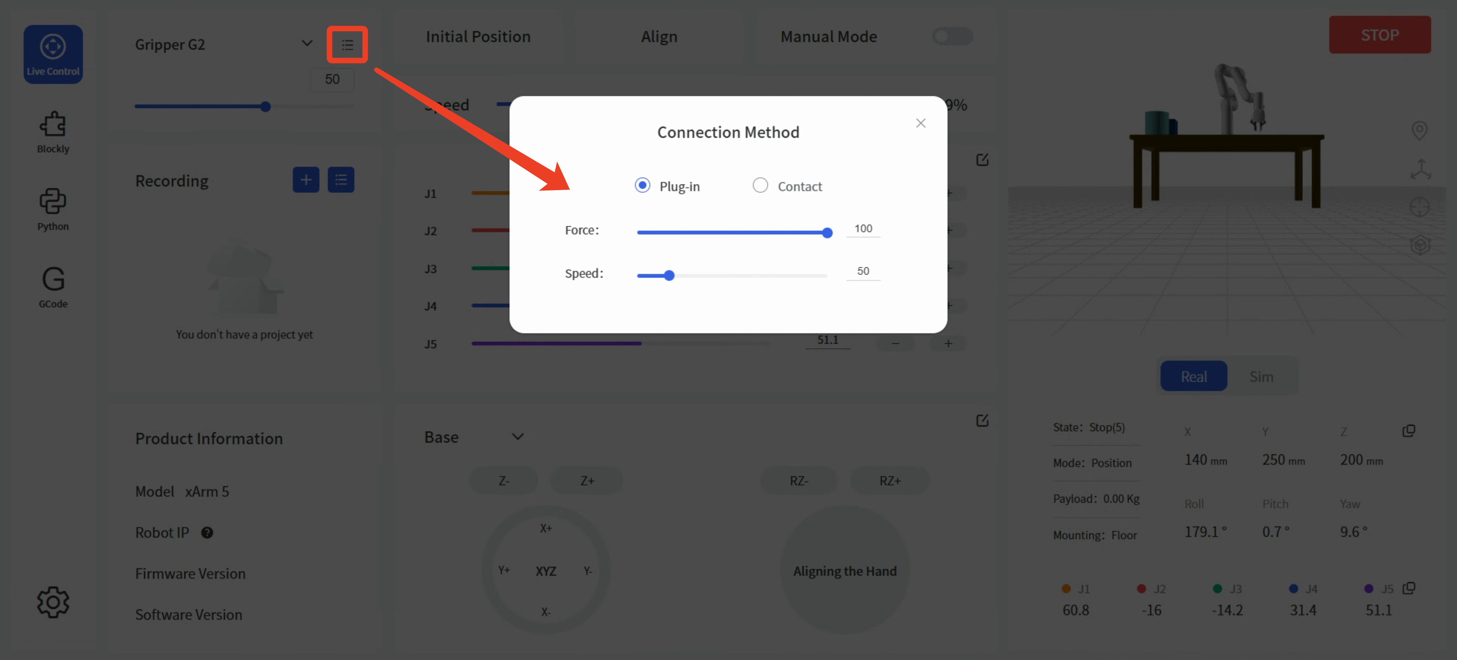

Enter the Live control page, select Gripper G2, and perform position control (range 0-840).
Click the button in the upper right corner to select connection mode and adjust gripping force/speed.

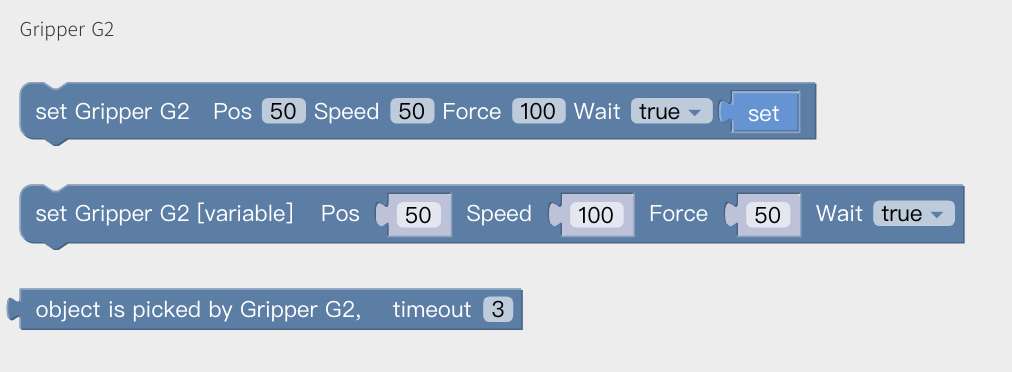

3.1.2 Blockly Control ​
Blockly provides 3 blocks for Gripper G2 control:
  • Set Gripper G2 pos[] speed[] force[] wait[]
  • Set Gripper G2 [variable] pos[] speed[] force[] wait[]
  • Object gripped by Gripper G2 timeout[]

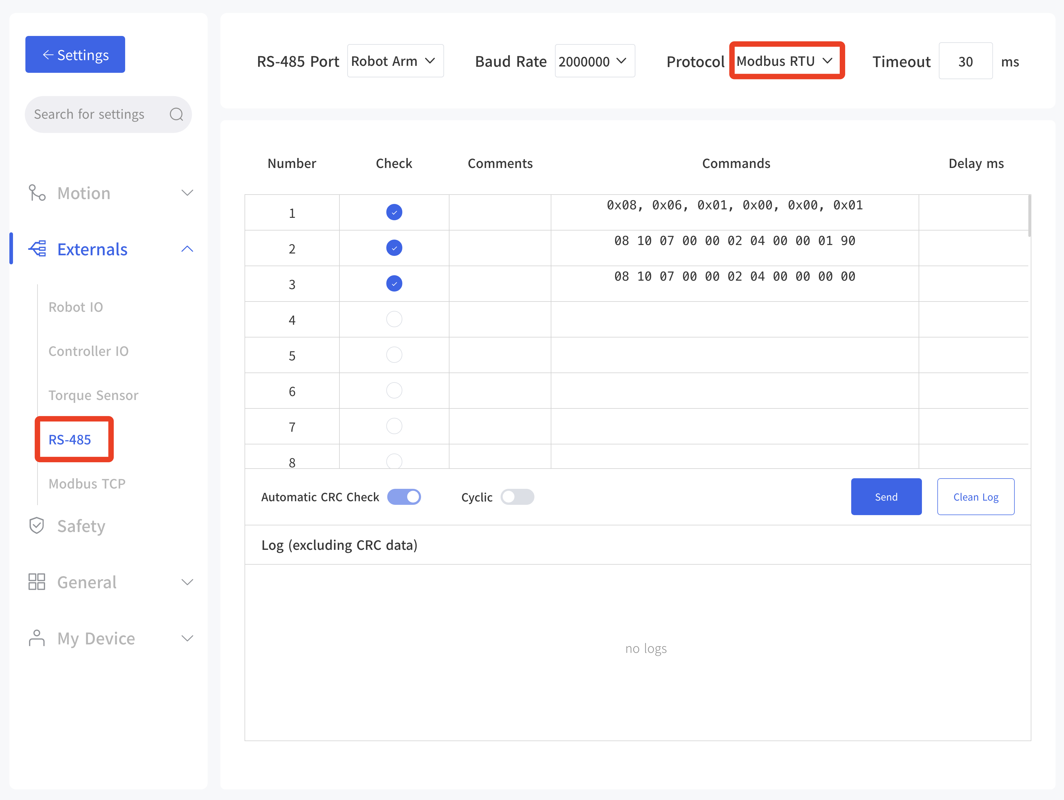

3.1.3 Modbus RTU Control ​
Go to Settings -> External Devices -> RS485, select Modbus RTU protocol, and send corresponding commands.
Refer to Chapter 4: Modbus RTU Protocol for details.

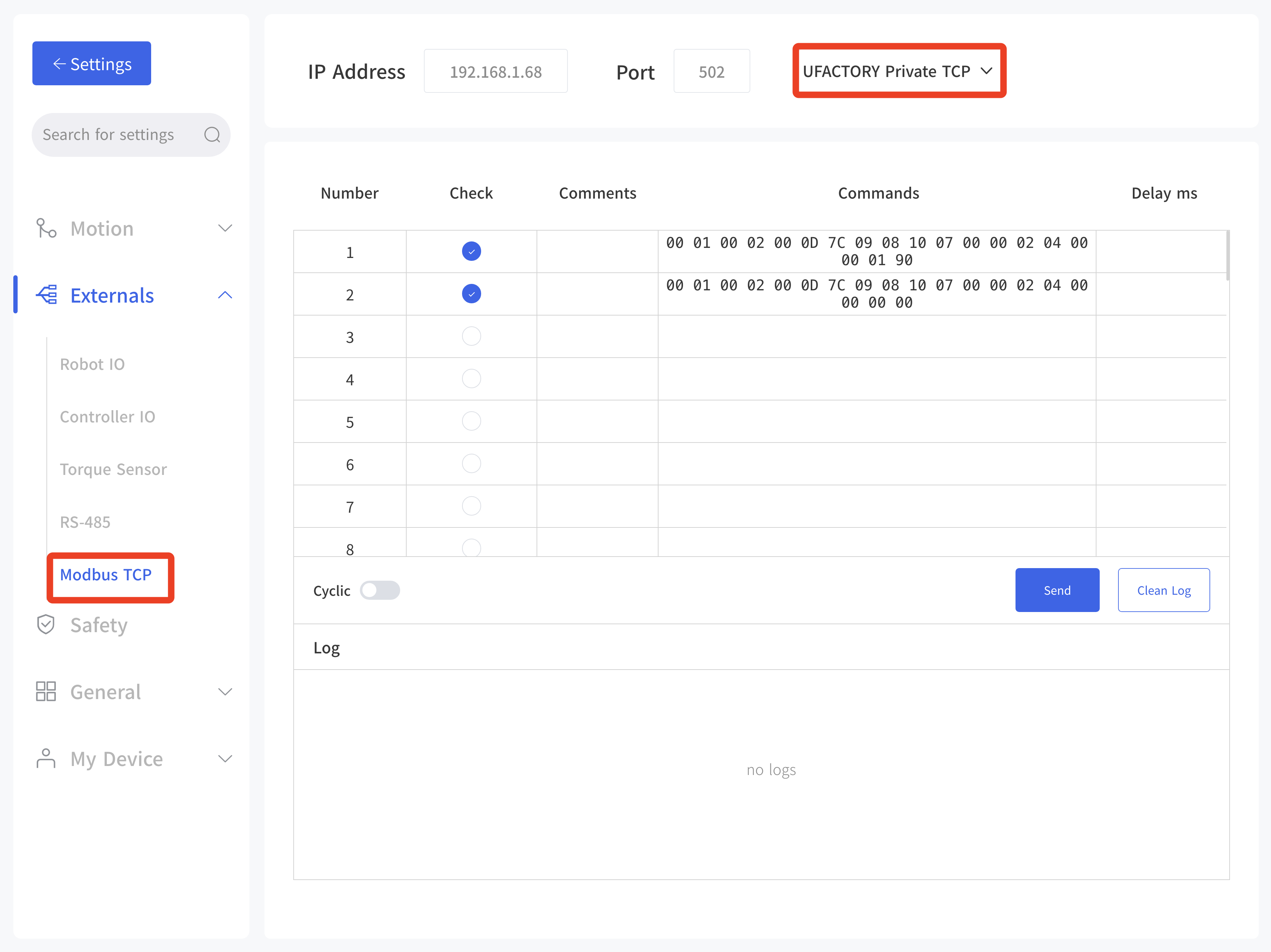

3.1.4 UFACTORY Private TCP Control ​
Go to Settings -> External Devices -> Modbus TCP, select 'UFACTORY Private TCP', and send proprietary TCP commands.
Refer to Appendix for UFACTORY Private TCP details.
