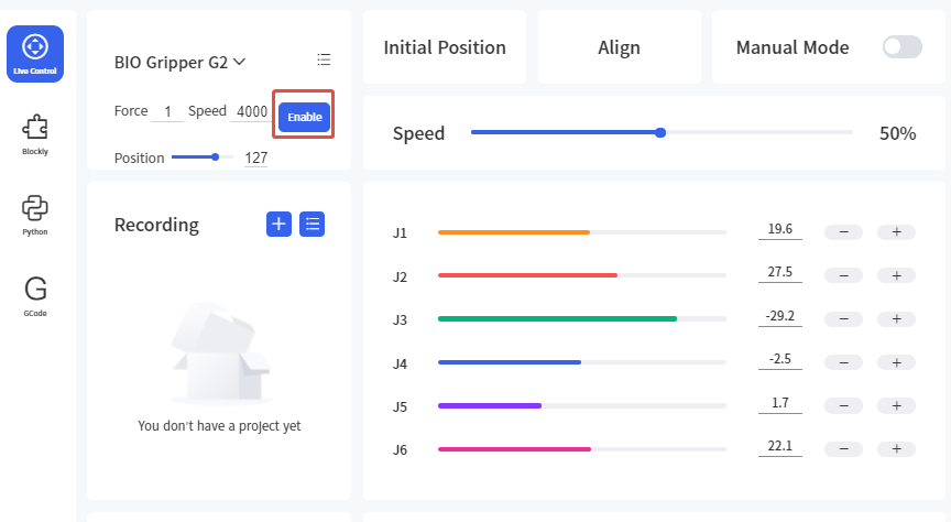

Re-enable the gripper: Select the BIO gripper G2 and click 'Enable'.
